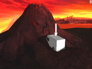

Off
Off is the method to move objects without regarding the contours of the terrain. You can always move in any direction and the object will pass through the terrain as if it is not a solid object.

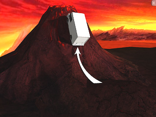

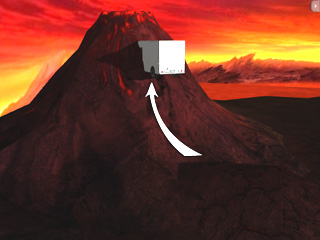

Snap to Terrain
When you drag an object to move along the terrain, the Move - Z data of the object will adjust automatically. This way the object's pivot will always move up and down along the contours of the terrain. This method is unrealistic for vehicles such as cars or bikes.
Snaps instantly when dragging and moving
Z value changes to snap to the terrain

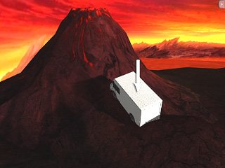

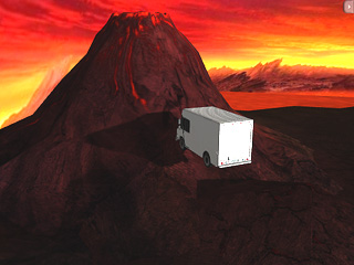

Follow Terrain
When you move an object along the terrain, not only will the Move - Z data of the object be adjusted automatically, but the Rotate - X, Y, Z as well because iClone tries to match the angle of the object's Z-axis to the Normal Directions of each face of the Terrain. This is the ideal method to use for all kinds of vehicles.
Rotate - X, Y, Z changes to fit the normal
