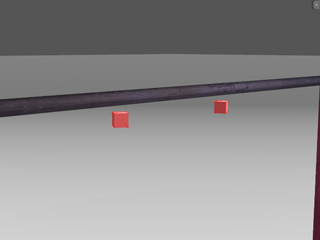

Each prop contains only one pivot for a target. Therefore, when a character wants to hold a prop firmly with both hands, both hands have to hold on to the same pivot, which causes hands penetrating each other; or the prop attaches to one hand, and the other hand can only strike a holding gesture that you need to constantly adjust if the prop or character moves.

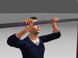

With the use of a dummy, you can easily reach both character's hands so that the dummies are attached to the prop. Even if the character or the prop moves, you do not need to worry too much about the results.
The bar has only one pivot. |
