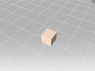

  1. Apply any 3D block to your scene. If you drag a prop into the scene, then click the Zero Transform Key button on the timeline to centralize the object.

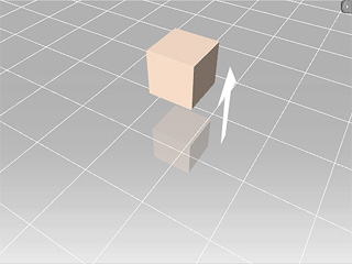

  2. Open the Transform track. There will be one key already in frame 1. Go to frame 20 and move the block up the Z axis to your desired height. You now have a taking off animation ready.

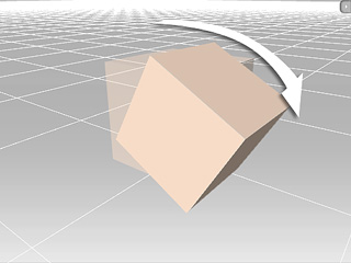

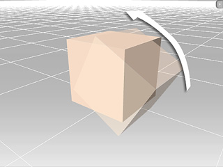

  4. Go to frame 30 and rotate the block along the Y axis. Click Zero Transform Key at frame 40. Now your rotating animation is ready.
