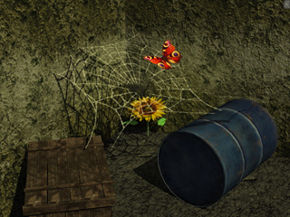

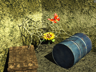

In iClone, the strength of each light is specified by the color. When you want to increase the strength and contrast of the light, you may de-saturate the color of the light to make the entire scene lighter in color.
By using the Multiplier feature of the light, you are allowed to keep the original color of the light while increasing the global strength and contrast. This feature applies to Directional Lights, Spotlights and Point Light. It provides room for an artist to turn ordinary animations into uniquely stylish ones.
Multiplier = 2.5 The light is brightened while the color of the light remains the same. |

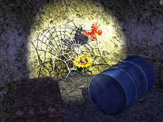

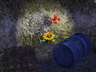

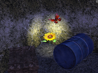

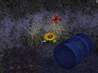

With the same concept, you may use the Multiplier to highlight the light center cast by the spotlight or point light.
The spotlight effect is dramatized after the Multiplier is increased to 3. |
The point light effect is dramatized after the Multiplier is increased to 3. |
