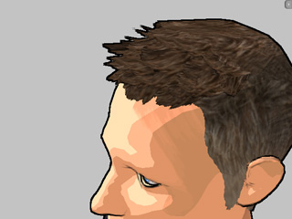

Removing Illogical Outlines from Character's Hair
Each character's hair contains Opacity textures, which may cause incorrect Toon Shader or NPR results.
By activating the Alpha Threshold box of the
hair, the visual artifacts can be removed.
Alpha Threshold = Off
Alpha Threshold = On
