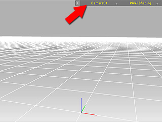

In the Preview Window, pick a desired camera from the Camera Selector.

What you're viewing through the Preview Window now is exactly what the custom camera would see.
In the Preview Window, use the Camera Selector to pick any camera other than the custom one you just created.

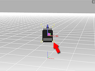

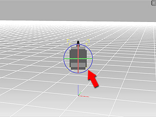

Zoom out the preview window and you may see the Gizmo of the custom camera.
