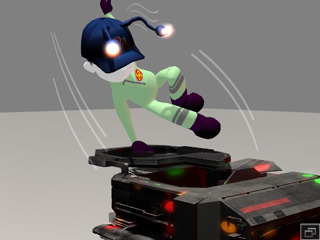

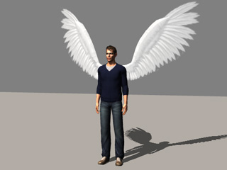

Apply a wing accessory to a standard character.
Right click on the character and select the Move >> Fly Backward command
from the right-click menu, and click on the ground to set the destination.
The character generates a body motion as it's flying. At the same time, the wings also
generate flapping animations. These two kind of data are automatically grouped in the
Timeline.
If you edit the clip (such as looping it), the other clips in the group will
react to the manipulation simultaneously.

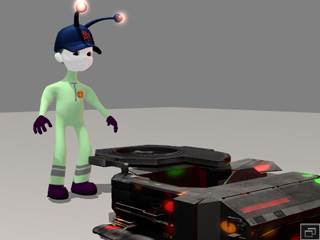

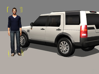

Character Operates an iProp
Whenever a character is commanded to operate an iProp, a group of the
body motions and the iProp animations will automatically be generated.
Select a character.
Right click on an iProp and select one of the Operate commands
from the right-click menu to have the character interact with the iprop.

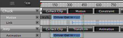

When the operation is done, a group containing body motions, iprop animations and even link
key data will automatically be generated.
Edit one of the components in the group (such as dragging).
The other clips in the group will react to the manipulation
simultaneously.

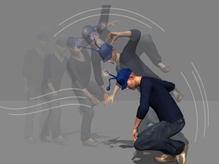

Create a character and attach an accessory, then animate both of them
in any way.

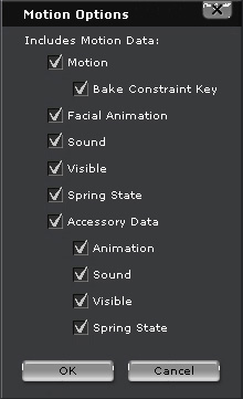

Use the Collect Clip feature to generate a MotionPlus
file and select the data that you want to include in the
file (if you are not sure what shall be activated, then activate
them all).
Create another character with an identical attached accessory in the same structure.
Apply the new character with the generated MotionPlus file.

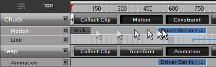

decelerate).
simultaneously.
Drag the right edges of one of the clips to decelerate the
entire group.

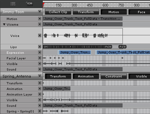

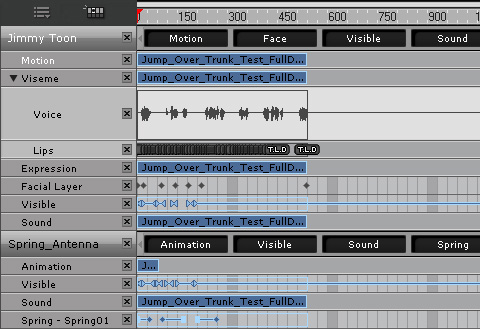

Splitting the Groups for Editing Individual Data
In addition to modifying the data group by group, you are able to break a group into pieces
so that you are able to individually edit the data inside of it. A
talking-walking character with an animated accessory applied with MotionPlus is taken as an example in
this section.
After an animated character and accessory is applied with MotionPlus,
the data from the file will be grouped in the Timeline as shown.
Right click on any clip-type data in this group and select the Split command from the
right-click menu.
The data in the group can be edited independently after the Split
command.
