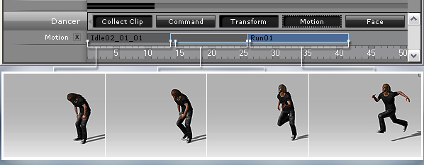

Each clip possesses two blending parts, one at the head and the other at the end. The head blending part can be adjusted while the end blending part can not.
When there is no previous clip to connect to, the blending part of a clip will blend with the idle motion.
Follow the steps below to have two motions blend with each other:
Have two clips applied into the Motion track (Idle and Run motions).
Pick the latter clip. The blending part will be shown before the clip. (Empty rectangle)
You may decide the start frame of the blending effect by dragging the left edge of it.
