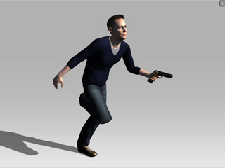

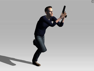

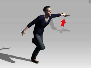

  • If you only set motion layer keys, then you will get an offset motion instead of an absolute pose. Use Remove Motion on an existing motion clip before setting motion layer keys, and the body parts whose motions were removed will have an absolute pose.
  • Add motion layer key without using the Remove Motion feature.
    Add motion layer key after using the Remove Motion feature.
