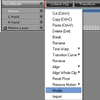

Open Motion Modifier
Apply a motion to an existing actor.
Launch the Timeline (Keyboard Shortcut:F3), open the Motion section of the actor
to show the motion-related tracks of the actor.
In the Motion sub-track, you can see the motion clip added in step 1.
Right click on the clip and select the Modify command from the right-click menu.

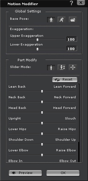

Adjust the motion clip with the Motion Modifier panel.
Base Pose and Exaggerations
The Base Pose is used as reference when you want to alter the entire strength of the
motion. After the base pose is determined, you are able to increase or decrease the exaggerations
of the motion clip for the upper and lower body.

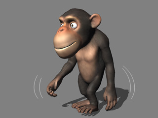

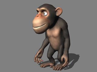

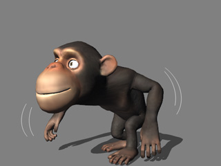

Creating New Look for Motions
Use the Motion Modifier, you are able to create a motion with new looks based on an existing one.
Load an actor.
Apply a motion to the actor.
In order to create a cohesive motion suitable to the character's personality, open the
Motion Modifier as described above.
Click the Stand Mode or Move Mode buttons in the Part Modify section
(in this case, the Move Mode is pressed).
Click the Preview button and press the Space bar to start previewing
(Shortcut: Spacebar).
Drag the sliders in the Part Modify section.
Click the OK button and the entire clip will be converted into an altered one.

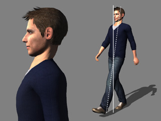

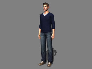

Fixing Slant or Stiff Issues
With the sliders, you can also correct
slant and stiffness issues when a G5 character is given G3 motions or
vice versa.
Apply a G5 actor.
Apply a G3 motion to the actor. The actor's neck and shoulders seem very
stiff and the body is slanted backward.

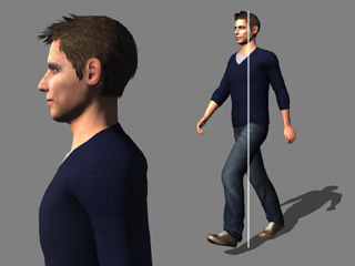

Open the Motion Modifier panel and switch to the Pose Correction mode.
Adjust the Hip Back/Forward and Head Back/Forward sliders to loosen the neck,
shoulders and rectify the actor's center of mass.
