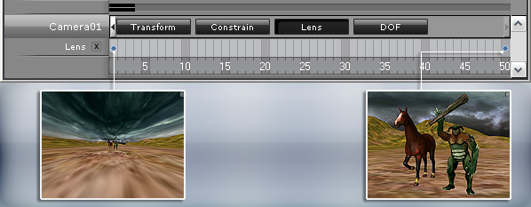

Choose one of the template buttons for lens focal length or drag the slider to define custom focal length. A new key will then be added into the Lens track automatically.

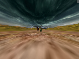

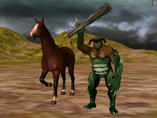

Go to another frame and change the lens value.
IClone generates the transition effect between the two keys.
The transition effect should look like the following illustrations. The camera looks like it is moving but it is actually the result of changing the lens focal length.
