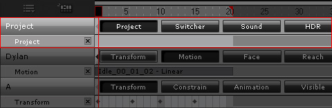

Open the Timeline (F3).
Click the Track List button and select Project to show the project track.
Press down the Project button. Click on the target
frame in this track.
