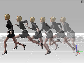

You may notice that sometimes the actor moves away as we apply an animation to it. You may want to modified this motion and make it a custom one to be used later as Perform, Walk, and Operate motions. To achieve this goal, it is better to have the whole motion to happen in the same position. You may then utilize this feature to prevent from setting the pose back to the same location manually frame after frame.
Pick one actor to apply a motion to.
Open the actor's Motion track. Apply a motion that moves the actor away.
You may optionally modify the motion via the Motion Layer track.

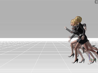

Select this motion clip in the Motion track. Click the Reset Motion Pivot button. The whole motion then happens at the same position.
