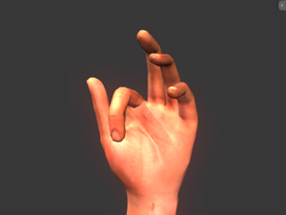

You may also curl all the fingers all at once by dragging the palm control.
Dragging Up |
Result: Fingers Curl Outward |
Dragging Down |
Result: Fingers Curl Inward |

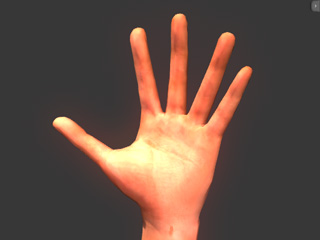

Dragging Left |
Result: Fingers Close |
Dragging Right |
Result: Fingers Spread Open |

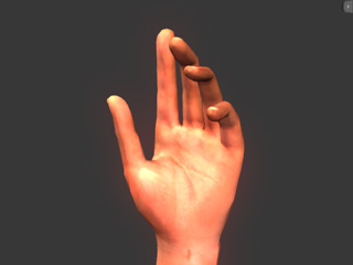

Press and drag the dummy's dark grey part of the fingers to set gestures.
Dragging Up |
Result: Finger Curl Outward |
Dragging Down |
Result: Finger Curl Inward |
