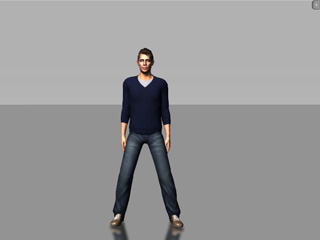

    Toggle the Screen-based Movement mode and record the hip panning to the left motion.

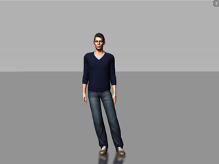

    Toggle the Screen-based Movement mode and record the leg stepping aside motion.

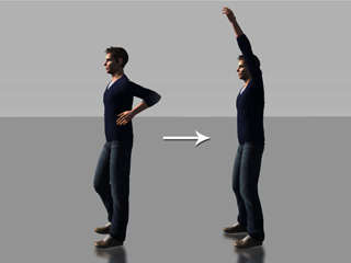

    Toggle the Screen-based Movement mode and record the hand stretching up motion.

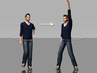

    Toggle the Primary-Rotation mode and record the waist rotating motion.
