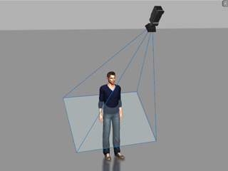

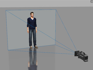

This is a way to puppet a body part on the plane of the screen. Take note that the angle of the camera does affect the puppeteering result. This is the freest puppeteering mode available; however, the body part may sometimes penetrate the body.
The camera viewing plane. |
The screen-based puppeteering result. |

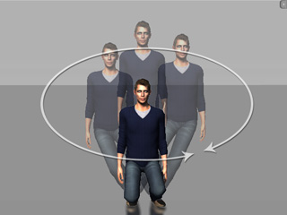

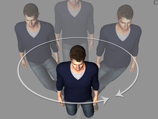

Rotate the camera viewing plane. |
The screen-based puppeteering result changes. |

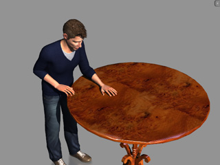

The Horizontal Movement is suitable for puppeteering body parts along the horizontal plane, such as a table; while the Vertical Movement is for body parts to move along the vertical plane, such as a wall.
When you want to use these two modes for wiping on a surface, remember to activate the Lock Rotate of the hand so that it does not rotate, as this auto-triggered by the forearm bones.

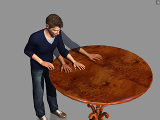

Use Horizontal Movement to puppeteer the left hand. |
The hand can only be puppeteered on the horizontal plane. |

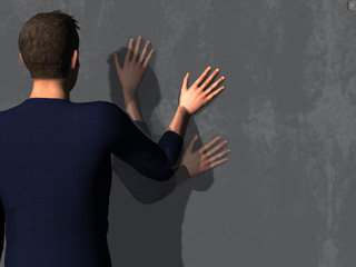

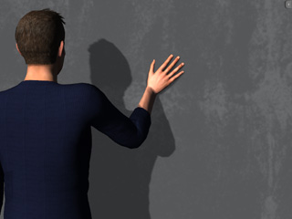

Use Vertical Movement to puppeteer the right hand. |
The hand can only move along the vertical plane. It is highly suggested that you rotate the camera so that the camera viewing plane is parallel to the wall. |
