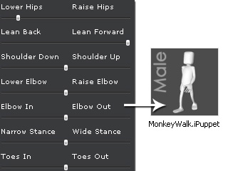

  1. Select a character.
  2. Select a category and pick a preset.
  3. Switch to the Preset tab. You will then see parameters sliders provided for this preset. Please refer to the Puppeteering Principles for Motion Puppet Panel section for more information.
  4. Start to preview or record. The character will keep repeating the motion.
    Initial walking motion
  5. Drag the sliders during previewing or recording, to change the motion weights of the body parts.

    • The number of parameters are different from preset to preset.
    • Please note that if you are using the Mouse Control mode, then the parameters in the preset tab will all be disabled. You must adjust the values before previewing or recording.
