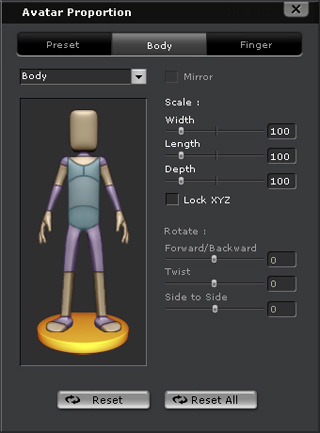

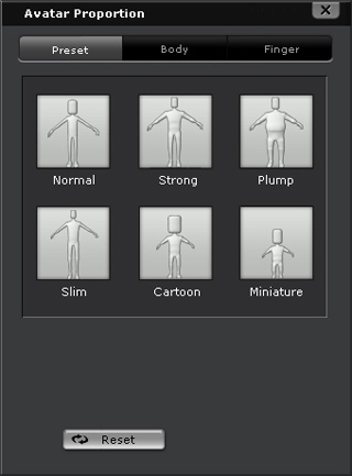

  2. Click the Avatar Proportion button in the Body Style section in the Modify Page.
  3. Click on the six preset templates in the Preset tab.

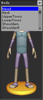

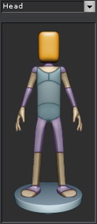

  4. If you want to adjust the individual body part, then switch to the Body tab.
  5. Select the sub node of the actor from the drop-down list. You may also click directly on the nodes of the dummy.
  6. Adjust the Width, Length, or Depth to change the proportion of the node.

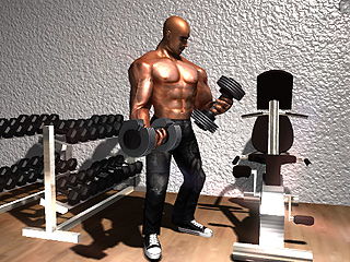

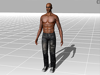

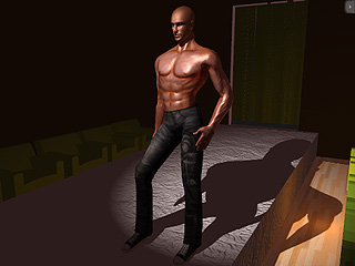

    Default Character
    Slim Model
    Strong Man
    • If you want to adjust the node of the limbs of both sides at the same time, activate the Mirror option and repeat steps 1 and 2 to modify the node.
    • The Width, Length and Depth settings can be locked according to the node you picked.

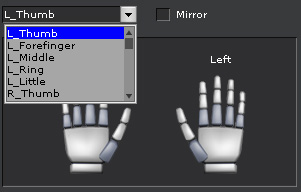

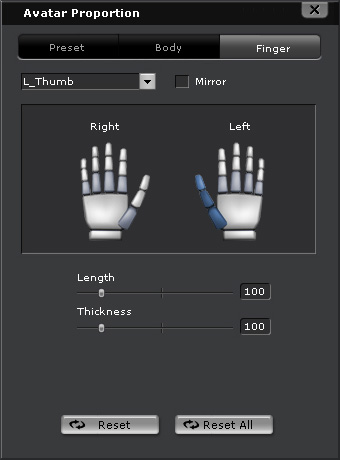

Adjust Finger
  1. Select the sub node of the fingers for the left or right hand from the drop-down list.

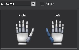

  1. Adjust the Length or Thickness to change the look of the target finger.
  • To select the whole finger, you need to select it from the drop-down list first.
  • Activate the Mirror option and repeat steps 1 and 2 if you want to adjust the node of the fingers or the whole finger of both hands at the same time.
