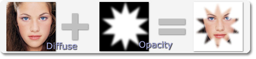

  • Diffuse - You can change the color or image for each particle.
  • Opacity - This parameter decides the shape and the transparency of your particles.
  • Please refer to Multiple Channel Texture Mapping for more details.

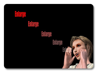

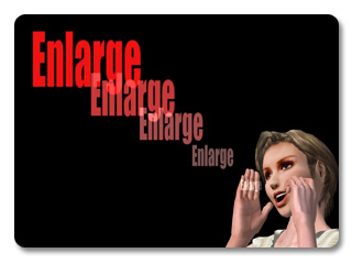

  • Start - You may decide the Width and Height as soon as each particle is emitted. The range is from (0 X 0) to (99999 X 99999).
  • End - These two parameters set the Width and Height of each particle when it vanishes. The range is from (0 X 0) to (99999 X 99999).
Start: 10 x 10
End: 10 x 10
Start: 3 x 3
End: 30 x 30

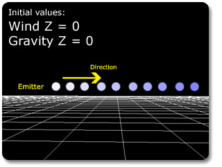

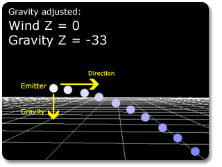

  • It creates a force field to pull particles in a fixed direction specified by three parameters. The strength of the field increases as the values move up. The speed of the particles are accelerating per unit of time.
  • X - Particles are pulled along the X-axis. The range is from -99999 to 99999.
  • Y - Particles are pulled along the Y-axis. The range is from -99999 to 99999.
  • Z - Particles are pulled along the Z-axis. The range is from -99999 to 99999.
Wind

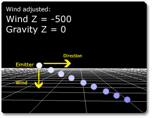

  • It simulates the effect of wind on the particles. The particles increase their velocity along the direction you set. However, the speed is constant instead of accelerating per unit of time.
  • X - Particles are blown along the X-axis. The range is from -99999 to 99999.
  • Y - Particles are blown along the Y-axis. The range is from -99999 to 99999.
  • Z - Particles are blown along the Z-axis. The range is from -99999 to 99999.
