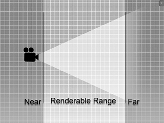

Rule of Clipping-planes
The Clipping-Planes provide two parameters, Near and Far, to define the render-able range of a camera.

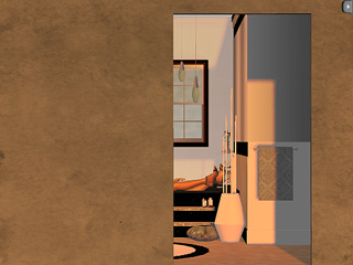

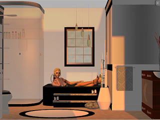

Setting the Near Value
If your actor is indoor, the wall of the room will always hinder the view. You may use the Clipping Planes - Near to filter out the objects within this distance.
  1. Go to Stage/Camera/Modify page.
  2. In the Camera section, click the up arrow of the Near.
Near = 0
Near = 40

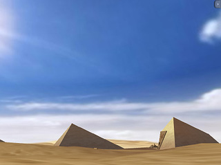

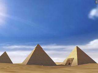

Setting the Far Value
If your Terrain is so wide that it is beyond the camera's rendering range, you may adjust this value to solve this issue.
  1. Go to Scene/Camera/Modify page.
  2. In the Camera section, click the up arrow of the Far.
Far = 9999
Far = 12000
