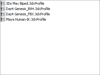

  1. Once you enter the Characterization mode, then click the Load T Pose button.
  2. By default, the system will open a build-in folder where the pose profiles are listed. If you can not find the profiles- the folders are built under the paths shown below:
  3. Select the profile that is suitable to the native 3D tool of your character (known source).

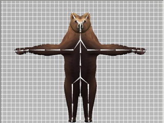

  4. The character will instantly strike a T-pose once the profile is applied to it.
  5. You may then slightly adjust the bones until you are satisfied with the look of the character.
