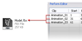

In this section, you may determine the geometries to be included into the FBX file.
In this section, you are able to determine if you want to compact the clips listed in the Perform Editor into single or multiple FBX files. To include animations, you need to activate the Include Animation checkbox.
Please also refer to the Animation Sampling Rate section for more information about how to sample data from the animation clips.
