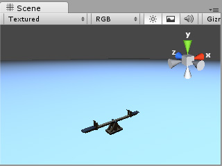

Jump-to-Origin Issue
Load a model and its animations to Unity.
Drag and drop the model to the Hierarchy tab. The model will be automatically
positioned to the origin (0, 0, 0) of the scene.
Make sure the model is selected and in the Inspector tab, then click the little circle of the Animation.
Select the animation of the model.
Transform the model by adjusting its position, angle and size according to your needs.
Click the Play button to start the Game Mode.
The model jumps back to the origin and turns to its original size and angle in the Game Mode.

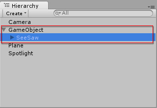

Make sure the model added in the previous section is removed from the Hierarchy tab.

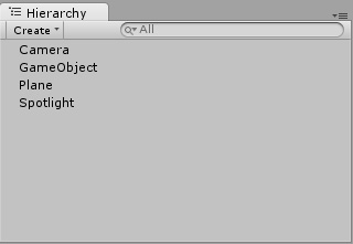

Execute the GameObject >> Create Empty command.
An empty object will be added into the Hierarchy tab.

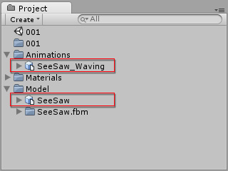

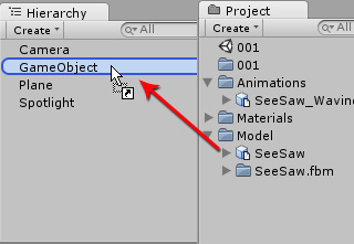

Drag and drop the model from the Project tab onto this empty object.
Drag and drop the model onto the empty object.
The model is set to be the sub-node of the object.

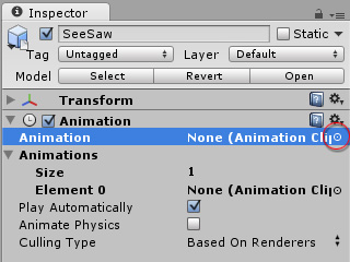

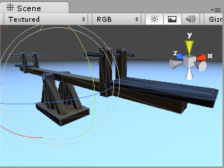

Select the GameObject and then transform it by adjusting its location, angle and size.

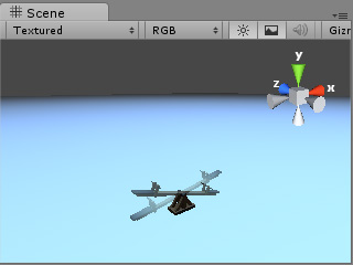

Click the Play button to start the Game Mode. The model starts
its animation with the adjusted appearance, and will stay where it is.
