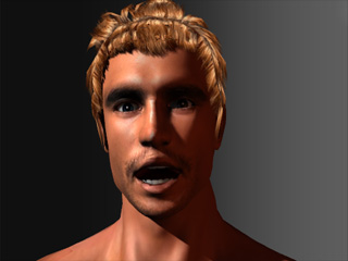

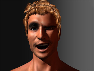

  2. Here is a typical result of fine-tuning a facial feature.
Before
After
