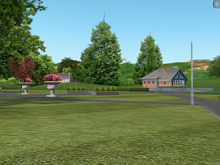

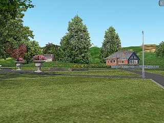

Anti-alias
An anti-aliased output will produce a smooth image with less jagged edges and pixilated areas. Check the box to turn the Anti-alias feature on.
Anti-alias Off
Anti-alias On

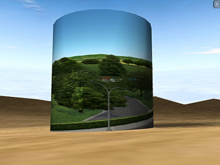

Mipmap
The Mipmap force to render object with gradually-lower-resolution texture along with the distance.
Mipmap Off
Mipmap On

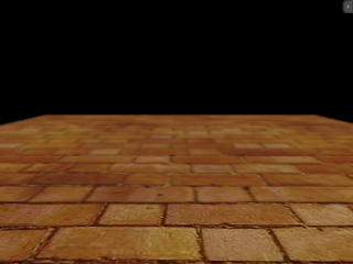

As the camera angle turns to be too oblique, MipMap feature may cause some surfaces that are near the camera blur. To compensate the disadvantage, you may increase the Anisotropic value to gain more mapping quality.
Anisotropic Off
Anisotropic = 16x

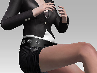

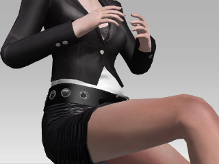

Max Real-time Map Size
Your textures may look blurry when you apply them to large objects or view them in a close-up. This could be resulted from the maximum allowable texture size.
The default texture size setting for iClone is 512 x 512. This setting determines the maximum allowable texture size. Therefore, if any texture is larger than 512 x 512, after you apply it to a 3D object, the texture size will be scaled down to 512 x 512 (pixel as unit), which results in the blurry look of your texture.
Users can define the maximum allowable texture size applied to 3D objects in Max Real-time Map Size tool in the Preference panel. If you have high-resolution textures, you can set the texture size higher (from 1,024 x 1,024 to 4,096 x 4,096) to maintain your original texture quality. Since texture images take your graphics card memory, please consider the overall texture budget for the optimized visual quality.
Source Image = 3000 x 3000
Max Real-time Map Size = 512 x 512
Max Real-time Map Size = 4096 x 4096
