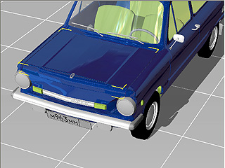

Load a model. In this case, the hood is missing because of the opposite direction of the normal.

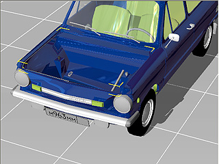

Select the mesh nodes that disappeared in the tree view.
Click the Flip button in the Normal section.
