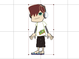

Character in Stage Mode
You are able to drag and drop any template from the Animation libraries (Motion, Face, Perform and Action Menu) to any character instead of selecting the template and clicking the Apply button.
Drag and drop a motion template onto the
character.
The character will start the motion.

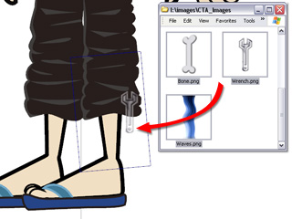

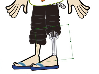

Character in Composer Mode
When you select a character and switch to the Character Composer mode, then you can drag and drop any props onto any body parts. CrazyTalk Animator will automatically attach the prop to the body part.
Drag and drop a prop onto the character.
The prop instantly attaches to the body part.
Note: You may also drag and drop from a folder to have the same result.

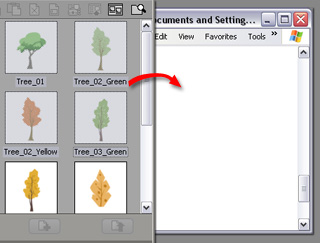

Assets Collection
You can drag and drop one or more assets, from the Content Manager, into your desired folder to create your a custom library collection.
Drag and drop assets from
CrazyTalk Animator to a folder.
Build a custom library collection.

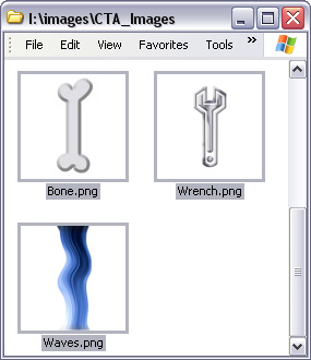

  1. Creating a Prop with Multiple Media
    1. Select multiple media file(s) in the source folder.
    2. Drag and drop into the working area of CrazyTalk Animator.
    3. Click the Prop button to create a new prop with these media.
