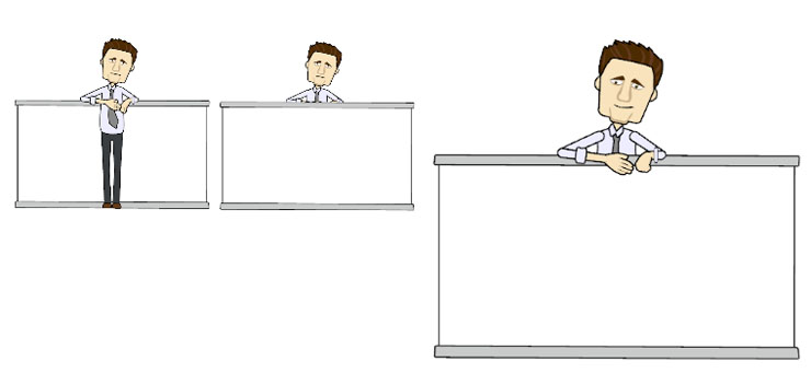

Placing Objects Between Body Parts |
Normally, objects cannot be placed between the different layers of a character. They are restricted to being in front or behind. |
| 1. Import in two characters that are exactly the same, only with each one missing different body parts. In this example, one character only has a head, arm and hands, while the other one only has a single upper torso. By placing the object between the two characters, you can get the result you're looking for. |
| 2. These 2 characters have the same motion and clothes. If you want to change the clothes or simply adjust a motion, remember that you'll need to do it for both incomplete characters to keep them in unison. Enter the Character Composer, then change the Upper or Head as desired. Then delete the parts that are not showing. |
