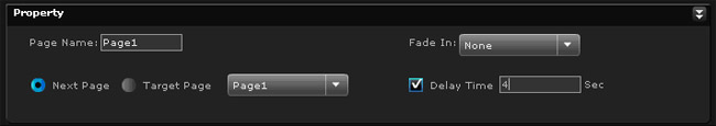

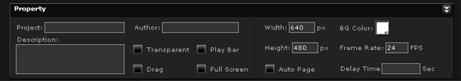

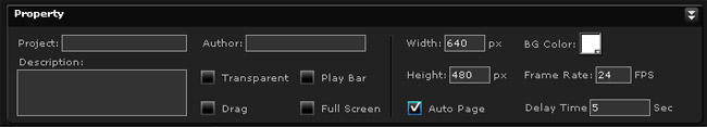

  5. Why isn't the "Play" button working in popVideo Composer?
    This button is only for reviewing delay time purpose only not for playing media source. If you want to set delay time for each page or globally as the default for every page, you will need to check Auto Page in Project Setting, or set the Delay Time in each page setting.
