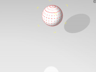

  1. Set a prop as a rigid body and perform the Rigid Body Simulation feature.
  2. Select the target prop whose animation you wish to keep after the simulation, and open the Timeline (Shortcut: F3). The animation keys will then be baked into a clip form and stored in the Animation track of the prop.

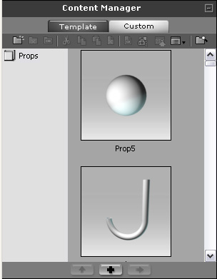

  5. Click the Add button under the Content Manager. The prop with its simulated animation will then be added into the library as a new prop.
  6. Drag and drop the new prop into the current project or any other projects. The animation remains while the prop is no longer a physics rigid body, unless you activate the physics settings again.
