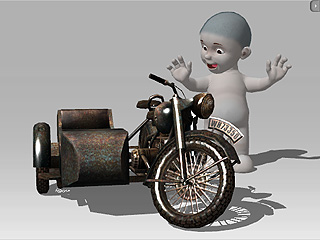

The actor looks at the whole object

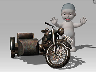

The actor looks at the sub-node
(the front wheel)

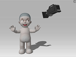

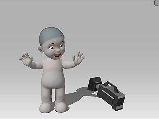

The actor rotates her head and looks at the camera all the time even if the camera moves away.
The actor looks at the camera
The camera moves away (the actor rotates her head to keep looking at the camera)

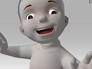

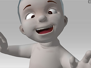

You may drag the Look At Weight slider to adjust the rotation weight of the eyes or the head.
The slider near the Head end
The slider near the Eyes end
To adjust the Eye Convergence, drag the slider to the Inward or Outward side.
The slider near the Outward end
The slider near the Inward end
