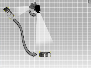

  4. Move the target object away to see the result.

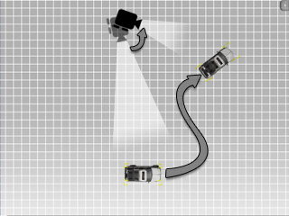

  5. The camera is driven to rotate and follow the moving car.
Example: A lady walks down the street with the camera following her.
