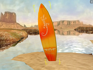

We will use a surfboard as an example to describe the UV reference.
  1. Select the prop in the current project.

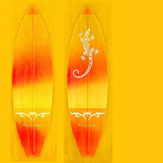

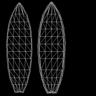

  1. Select the Diffuse channel and click the and buttons to open the diffuse and UV Reference images at the same time.
You will notice that the texture orientation (left illustration) is based on the texture
coordinate definition of the UV map (right illustration)
