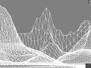

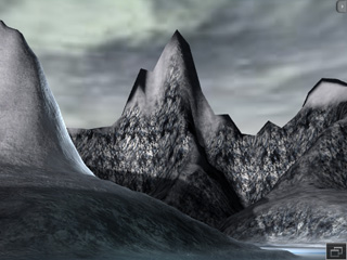

    LOD = On

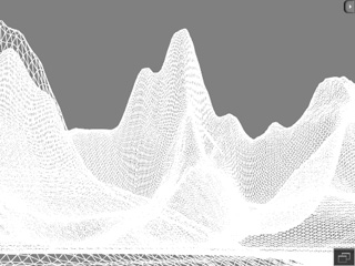

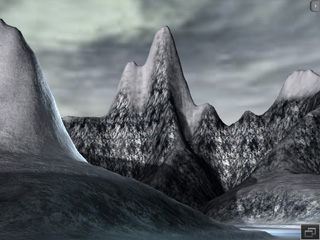

    LOD = Off

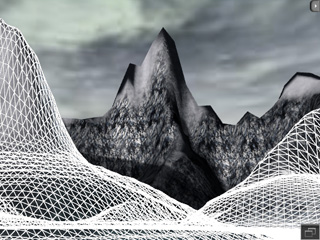

    Rendering the surface details will decrease the performance of your system.
  5. Adjust the Performance/Quality slider to determine the distance from the camera for starting the LOD effect.
    Performance > Quality
    The near surface details are decreased as well for increasing the performance.

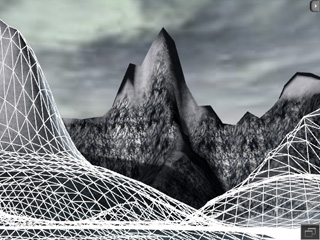

    Performance < Quality
    Increasing the quality of the details for the terrain surfaces.
