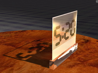

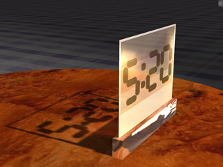

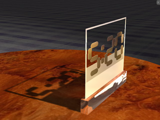

The shadows for props with Opacity map can be individually set in the Modify panel. If the opacity texture is grayscale, then you can decide the look of the shadow according to the object's Opacity image.
Prop without Opacity texture. |

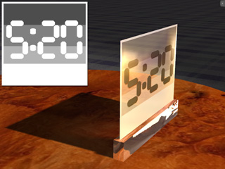

Prop applied with a grayscale opacity texture. The shadow does not change with the transparency levels of the prop. |

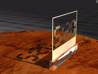

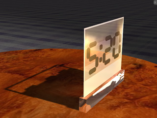

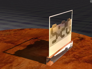

IClone provides Alpha Threshold and Shadow Threshold settings for adjusting the shadows of props with opacity maps.
Shadow Threshold = 30 |
Shadow Threshold = 50 |
Shadow Threshold = 70 |
Alpha Threshold = 30 |
Alpha Threshold = 50 |
Alpha Threshold = 70 |
