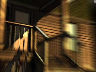

With enhanced post FX rendering options, you can render and create key-able visual effects like blur lens, sketch or black & white.
This allows for a wide range of amazing post effects that transform any 3D animation into top-notch, studio art motions.

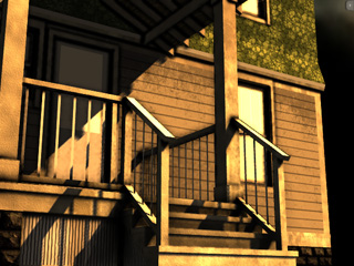

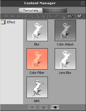

Applying Effects from the Effect Library
Prepare a project.
Go to Stage >> Effect. You will see
several built-in templates in the Content Manager library.
Double-click on one of the templates.

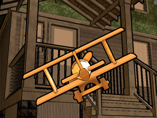

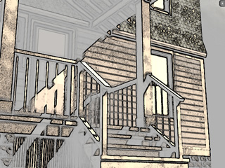

NPR (Non-photorealistic Rendering) effect applied

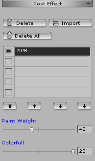

Modifying Current Effects
Each applied effect contains one or more adjustable sliders for you to define the weight or strength of the effect.
In the Modify panel, select a template in the list.
Under the list pane, drag the slider or sliders to adjust one or more parameters provided by the effect.

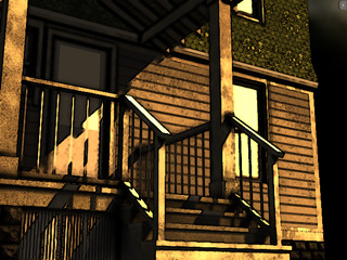

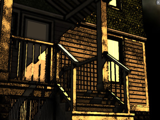

Effect: NPR (Non-photorealistic Rendering)
Paint Weight = 100
Colorful = 20
Paint Weight = 40
Colorful = 6

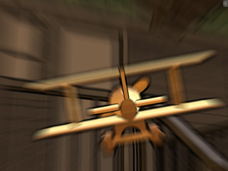

Effect NPR + Lens Blur

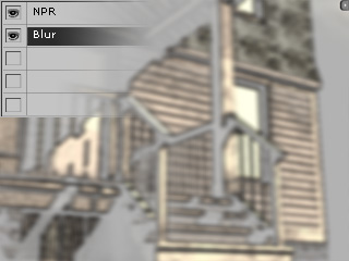

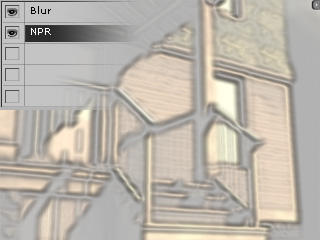

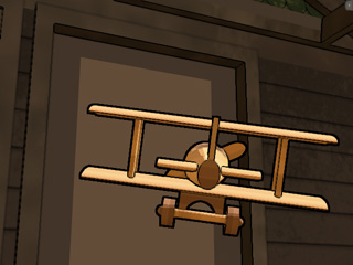

The order of some effects in the list can cause different result since the effects are layer-based filters. The
outcome of an effect is produced according to the effect on the lower layer in the list.
Effect NPR applied first
Effect Blur applied afterward
Effect Blur applied first
Effect NPR applied afterward
You may use the , ,
and buttons to arrange the order in the effect list.
