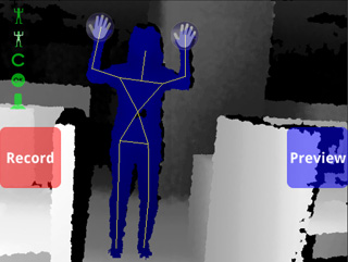

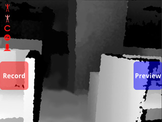

Go back to the Mocap Device Plug-in and activate the Body Command box.
The preview window of the Mocap Device Plug-in will instantly
display Preview and Record hotspots.
Follow the standard steps for the Mocap Device Plug-in to calibrate your skeleton properly.
After the calibration countdown, you will see two hand icons that follow your hands as you move.
Move the right hand icon to touch the Preview hotspot
and hold the pose for one second to start the previewing mode.
Move the left hand icon to touch the Record hotspot
and hold the pose for one second to start the recording mode.
When you want to stop previewing or recording, then you may move both hand
icons to touch the marks and hold the pose for one second; the
previewing or recording mode will stop.
