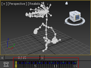

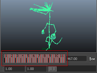

By selecting the bone of the character in your favorite 3D tools, you can see the baked keys on the timeline.
Select the bone in Maya. |
Select the bone in 3DS Max. |

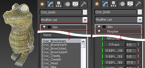

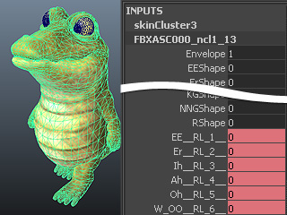

Select the body mesh in Maya. |
Select the body mesh in 3DS Max. |
