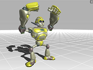

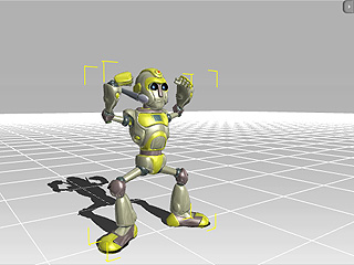

Adjusting Along the Body Proportion
If you intend to have the part to be changed along with the CloneBone's specific bone node, you may follow the steps:
  1. Pick the actor and make sure the Inherit relationship (Move, Rotate, Scale) between the target part and the bone node are all checked.
  2. Go to Actor/Avatar/Modify page.
  3. Change the body proportion in an ordinary manner. Please refer to the How to Change the Proportion of Each Sub Node of an Actor section for more information.
