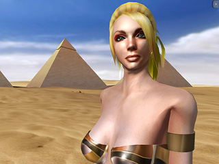

The actor looks at the whole object

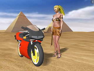

The actor looks at the sub-node
(the front wheel)

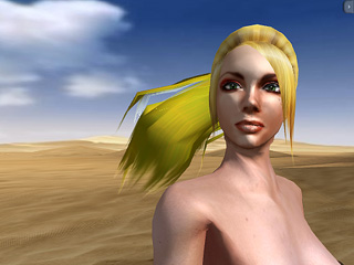

The actor looks at the camera

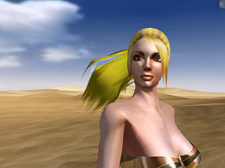

The camera moves away (the actor rotates head to keep looking at the camera)

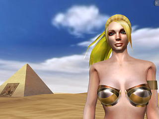

The slider near the Head end
The slider near the Eyes end
To adjust the Eye Convergence, drag the slider to the Inward or Outward side.
The slider near the Outward end
The slider near the Inward end
