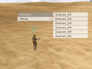

Click the Right Mouse Button on the target actor to bring up the list of actions available for that character.
