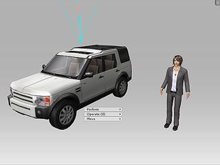

If you want the actor to interact with the iProp using a different action, please follow the steps below. In this example, the jeep is the target iProp and the man is the actor.
  1. Drag and drop the jeep from the library.
  2. Select the actor that you intend to interact with the jeep.

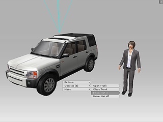

  3. Click the right mouse button on the jeep to pop up the right-click menu. Move your mouse over the Operate entry.
  4. Select the desired Operate function from the sub-menu.

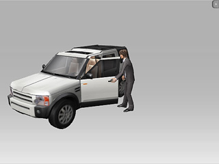

  5. The actor then automatically interacts with the jeep, performing your chosen action.
The actor walks to the jeep and opens the door.
