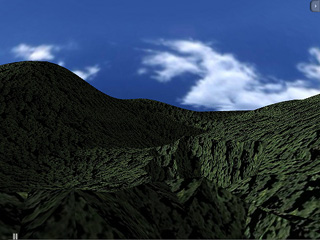

Before Water Applied

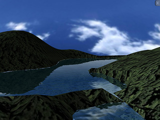

After Water Applied
You may use Ctrl - F7 to turn on/off the effect of water, or go to Modify page to uncheck the effect of Reflection and Refraction to decrease the loading of your system resources.
