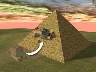

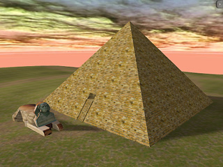

  3. Apply another prop (Sphinx) and drag across the terrain to see the result.
  4. Check the Use Bounding Mesh box. Drag the prop across it again and see the different result.
Use Bounding Mesh = OFF
Use Bounding Mesh = ON

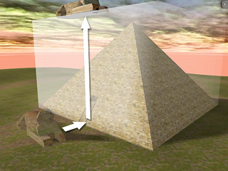

  • To examine the bounding mesh of a prop before adding it to the Terrain, go to the Scene Manager and change the setting from Normal to Bounding Mesh. You can also Right Click on the prop and choose Display then set the Render State to Bounding Mesh.

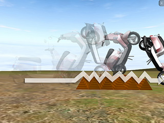

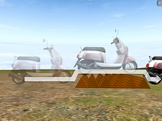

This feature is useful if you want to utilize the Follow Terrain or Snap to Terrain function in iClone. It avoids your objects from twitching as they are crossing a complicated but small fold of the terrain components.
