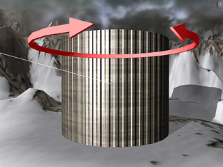

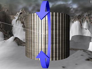

  3. Drag the left (or right) mouse button along the horizontal/vertical line to adjust the longitudinal/latitudinal degree of the directional light.
Drag horizontally
Drag vertically
