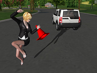

None
Self-Cast Shadow (Directional Light)
Self-Cast Shadow (Spotlight)
The Shadow is turned off.
The Shadow is turned on with directional light.
A realistic way to calculate the physical
projection of shadows from the light source via the shadow map technology.
Cast and receive shadows both from
characters and props/scene.
Shadows can be cast to the source's own surface as well.

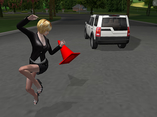

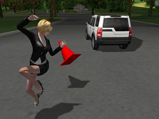

Drop Shadow

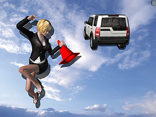

Wall Shadow
A quick way for characters to drop shadow
Only on the virtual floor (X-Y plane) or 2D
background.

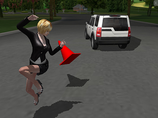

Wall Shadow shows an offset shadow directly
behind the character creating a 2D shadow
effect. If you select this option,
the Offset X, Y will be enabled for you to
define the position of the shadow.
Please notice that the Wall Shadow casts
merely on the 2D Background and Sky
but not on the Terrain.

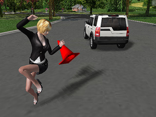

More about Self-cast Shadow

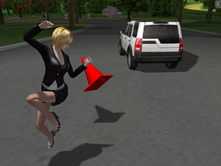

Shadow Opacity
Adjust the Opacity value may define the transparency of the shadow. Basically, the stronger light casts higher opacity shadow, especially the  directional light
Opacity = 60
Opacity = 100

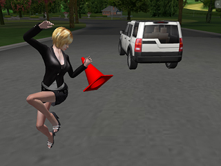

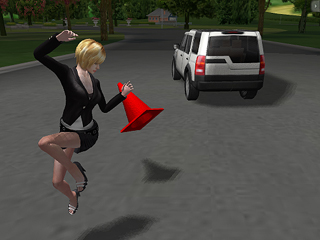

Blur
Check the Blur box to enable this feature. Adjust the Blur Level value may define the softness at the edge of the shadow.
Blur Level = 1
Blur Level= 10

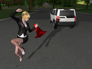

Shadow map resolution
Large scene takes larger size shadow map to make the self-cast shadow with higher resolution. However, it takes more resource of your system as well.
Resolution = 512 x 512
Resolution = 4096 x 4096

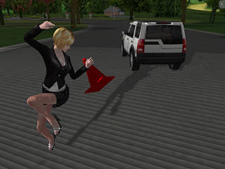

Shadow Bias Adjustment
This function helps to correct some shadow displacement caused by extreme shadow angle.
Bias = 1
Bias = -3
