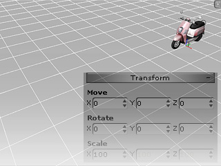

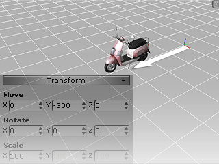

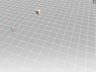

  1. Apply one regular prop and open its Transform track. The current transform data is added into the first frame in the track.

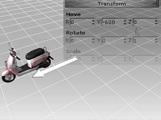

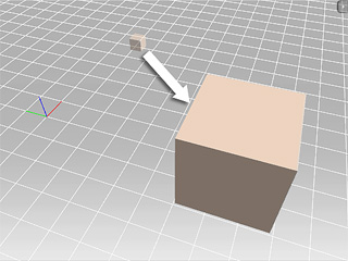

  1. Go to desired frame, add one key by moving, rotating or scaling the object.
  2. If you are not satisfied with the result and you want to reset the data, you may either:
    Adjust the transform again in the same frame.

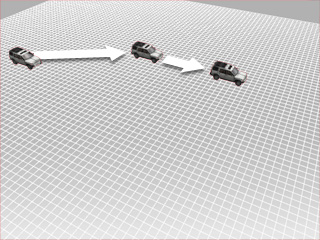

  1. Go to another frame later than the key added in step 3. Click the Zero Transform Key. iClone will then add a neutral key to cancel the effect of previous keys.

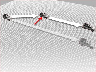

    2. Go to another frame. Click the Zero Transform Key. iClone will then add a neutral key to cancel the effect of all the previous keys in the track.

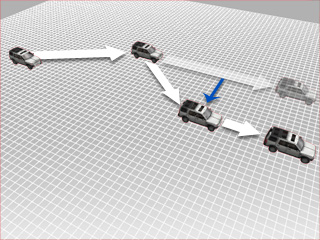

  • When the car moves to the location
    as shown in the illustration, press the
    Zero Transform Key button.
  • A new Zero Transform Key key neutralizing
    the prior effect is then added.
  • The path is back to the original one.

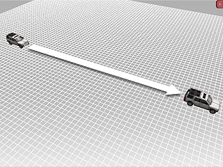

    Initial Position
    Set a Transform Key.
    Use Move Command to move the iProp.
    The Transform Data are modified following
    the formula above.
