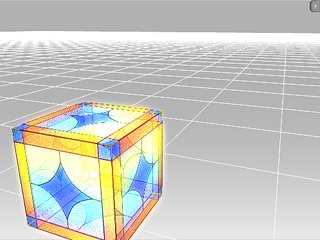

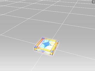

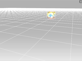

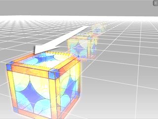

Move
Start Frame: 0
Move Key Added: (-100, 500, 0)
End Frame: 300
Move Key Added: (0, 0, 0)
Start play back and the box will move automatically
from (-100, 500, 0) to (0, 0, 0)
within the frame range.

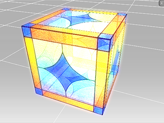

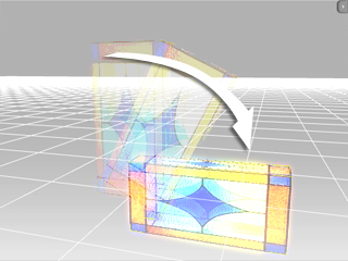

Rotate
Start Frame: 0
Rotate Key Added: (0, 0, 0)
End Frame: 300
Rotate Key Added: (0, 90, 0)
Start play back and the box will rotate automatically
from (0, 0, 0) to (0, 90, 0)

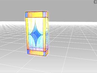

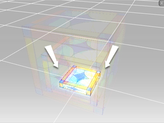

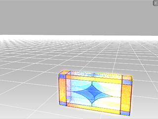

Scale
Start Frame: 0
Scale Key Added: (100, 100, 100)
End Frame: 300
Scale Key Added: (50, 50, 10)
Start play back and the box will scale automatically
from (100, 100, 100) to (50, 50, 10)
