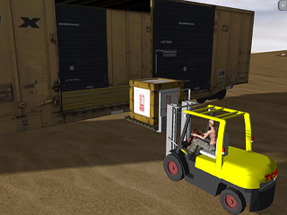

  1. Pick the crate and go to the desired frame to link it to the forklift.
  2. In the Modify page, scroll to the Linkage section.
  3. Click the Pick Target button and click on the forklift. You may optionally align the crate to the forklift if its position is not adequate.

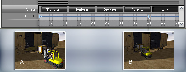

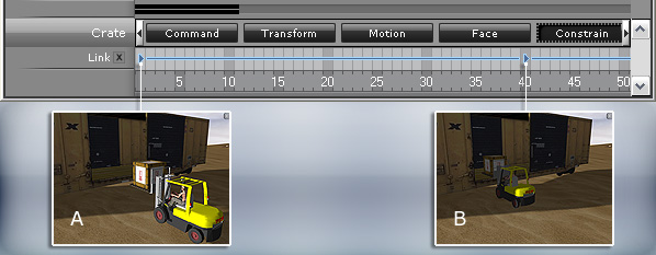

  1. Go to another frame, click the Pick Target button again, and then click on the train as the new target.

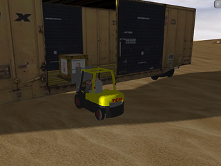

  1. The crate will be brought away by the train afterward.
A: Link the crate to the forklift
B: Link the crate to the train
