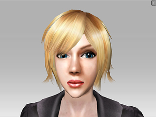

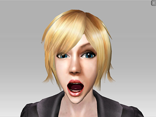

The avatar open mouth with
a down-moving jaw in
CrazyTalk 5.

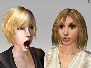

The G3 actor (Left) opens her mouth with
a down-moving jaw while the G2 actor (Right)
slightly opens her mouth without moving her
jaw.
